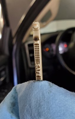

1. When I check the oil on the dipstick, it looks very black. On other vehicles the oil always still looks amber when it is just a thin film on the dipstick, even if it is old and black when drained. Is this a diesel thing? Or?

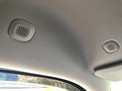

3. What are these little square things in the headliner? There are 6 of them. They look like tweeter speakers, but I can't detect any sound from them, and I don't think the Tradesman trim level would have such a fancy sound system.

Diesels make oil black super fast, but the oil is still good. You can always do a uoa from blackstone to learn about oil life. This is why bypass setups are so popular on diesels.

Black oil is a diesel thing.

Those are headliner vents in your Tradesman. For upper level trims some have rear tweeter speakers and a smaller grill in front for a microphone.

I just purchased my 2020 Ram 2500 6.7 L CTD 6-8 weeks ago. Checked oil today... not quite 1300 miles on it. This is how it looked. Quite black for such limited miles. I had to do some research to determine that's normal for diesels.
Still makes me want to change it. Also thinking about installing a bypass filter.

That oil is clean compared to mine. It’ll get darker. Trust me.

Oh, I know. The point is that I wasn't even to 1300 miles yet. No way I'm waiting until ~15k miles to change that oil.

You'll get used to it. When I change the oil in the 8.3 Cummins in our diesel pusher (over 20 quarts), it looks like that pretty much right away.
The looks of an oil, especially in a diesel, has nothing to do with its ability to perform at spec.
That oil is perfectly fine. Just because it is black means nothing. If you had an oil analysis done on it you would see it is fine. Been doing 15K oil changes on mine since day one and even at 15K the oil has plenty of life left in it (verified via oil analysis)
In diesels the oil will go black as soon as you run it. Don't worry about it , Completely Normal!
