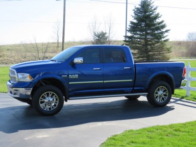

Everything is included and installation is fairly easy. If your truck came with tow hooks from the factory you'll have to remove them for the body lift. I bought the non tow hook inserts for the front bumper to fill in the holes. I have billsteins on the front set at 2.1 with 295/65/20's on 20x9 +1 offset wheels and the dual exhaust tips can be loosened and rotated up a bit to align with the new bumper height.

I had never thought about running my Bils with the body lift until now; looks awesome!!!

that is exactly the pic and info I needed thanks your truck looks awesome. The pic also showed me what my oem flairs will look like.

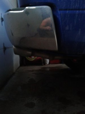

Wow! Looks great, i love that blue! Unfortunatly when i bought mine there was no Laramie available in blue with the Rambox.
That's the 3 inches not the 1,5 body lift, right?
And in rear, any coil spacers?
I have bils at 2.1 too and would like a little more height, but do not want to put 2k on a 4" lift..
How did you trim your chrome bumper in rear?
I'm scare to grind it and rust to appear.
Thanks!
929rob
Dec 1, 2015
23
14
3" performance accessories body lift. No coil spacers or anything in the rear. Trimmed bumper with air powered cut off wheel and coated the cut area of the bumper with por 15 rust inhibitor. It's been through 2 winters and no signs of rust.

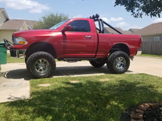

I have a 3 Pa body lift with gap guards. Iv had the BL since 10 and no issues at all. If you have 2 exhaust pips you will have to have them raised up 3".

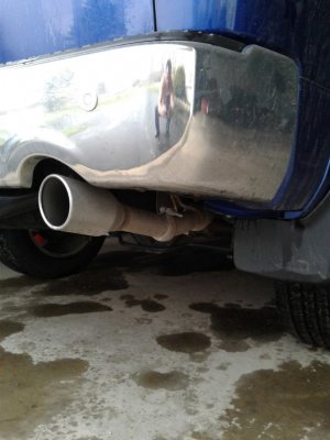

3" PA body lift and no exhaust Mod just loosened the clamp an adjusted it to what you see . Took about 2 minutes total
