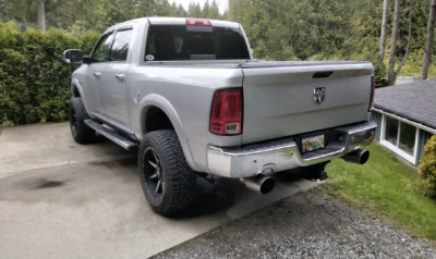

Here's my EcoD with the Performance Accessories 3" body lift kit and freshly installed Eibach Pro Lift front coils (2.75") and struts set on second notch for 3.5". I already have Bilstein 5100's in the rear with Eibach 1" lift coils and a set of Timber Groove air bags. My final measurements are....43" front and 44" rear. The ride is smoooooth and I couldn't be happier with final look of this not too high lift. Pictures definitely don't do it justice as it really looks like a much bigger truck in person........

Dude that looks sweet. I’m curious if you actually got 3.5”. I’m on the 3rd notch and got 3” on my truck. However I know you have the ecodiesel and they sell different springs for the eco. How do you like the ride?

Man that looks awesome!! I’ve been thinking about the 3 inch body lift kit, but I always thought it would look goofy, but your looks sweet! Any evidence of the body lift if you look closely? I’m also concerned about getting the dual factory exhaust lining up with the bumper cut outs.

Only evidence would be exhaust tips but that is easily fixed. In my case I've got a set of 6" MBRP tips that make up for a lot of the gap. I also purchased the PA gap guards for the front wheel wells but haven't seen the need for them.
Hey Crazykid, I had a 2.5 lift before with the 6112's and I have gained a full inch of lift with the Bachs going from 42" to 43" up front. The ride is really nice.....super smooth. Definitely softer than the 6112's but I did have a totally different setup with them.....2" ReadyLift strut top spacer and .05 lift on the strut....as the EcoDiesel can only achieve 2.3 maxxed out with the 6112's using the top setting.
Interesting. The eibach combo feel softer than the 6112?
Softer yes. The 6112's were stiffer on the Eco at the maxxed out setting (2.3) When i say stiffer I mean in a sports car kinnda way, if that makes any sense. I went to the 2" top spacer to see if I could get a little more lift and soften the ride which I did accomplish but after a lot of reserch I decided that running a spacer wasn't the best option.....kinda defeats the puprpose of the strut lift. So the Eibachs have ticked all the boxes so far in terms of lift and ride quality for sure.
