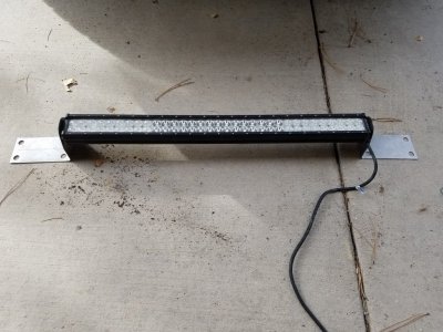

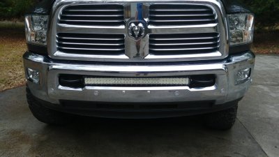

Gotcha. If you don't have the tow hooks it's not an issue. I have a bar that is 30" end to end and barely got it between the tow hooks with home made brackets.
