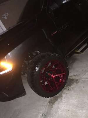

Mine rub just slightly on reverse I’m running 33x12.50r22 on 22x12 -44
305/55 are 12” wide so it might work

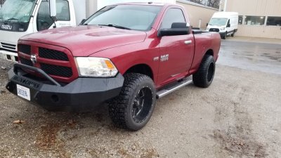

I have 3ix13.50x20 nitto trail graps on 20x12 -44 V rock wheels and 6" lift. Problem isnt the height, its the width of the wheel and tire.

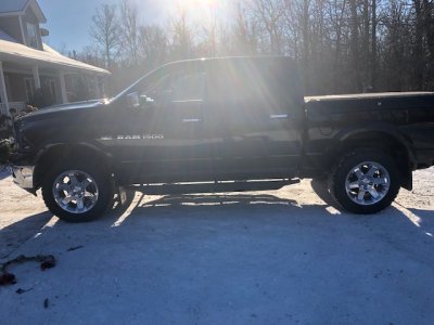

I'm running the exact setup 33 12.5 22 with -44 front has 3 inches and it does not rub one bit

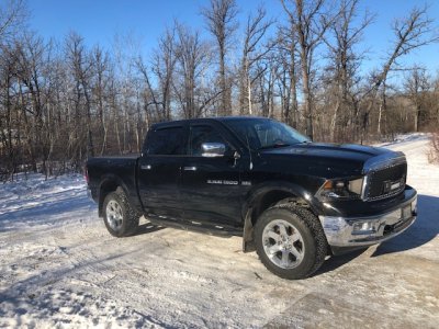

I'm running the Bilstein 5100's set in the middle (2.0) inches and kept level kit on top of that yet-0 drivetrain issues in 4wd-2.5 coil spring spacers in rear-floor to fender at rear is 41 inches,front is 39.5-Tires are 305/55/20-Will be adding 35/12.50/18's on new rims with 0 offset

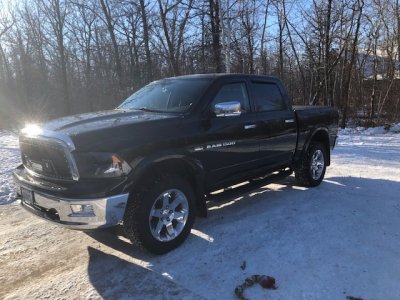

Bilsteins won't fix the issue. I have 35x12.50 tires and 20x12 -44 wheels, Bilsteins set to the max and the inside of my fenders are tore up from the tire. It actually rubbed so much, that it doesn't rub anymore.
