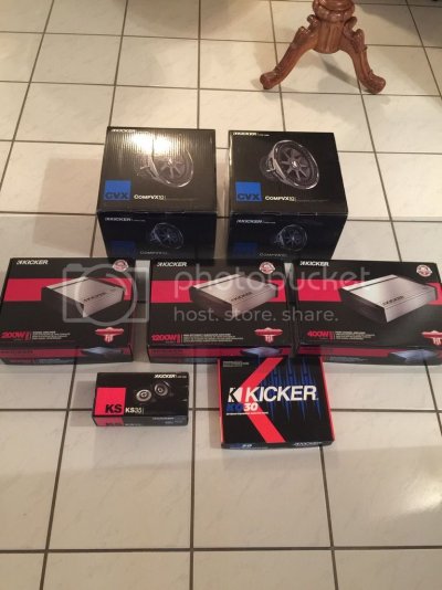

Finally pulled the trigger on my audio build for my truck. After getting together with my audio guy this is what we pulled together:
2- 10" Kicker Comp VX
Sub thump box
Kicker KX 1200.1
Kicker KX 400.4
Kicker KX 200.2
Kicker KS. 3.5
Alpine SPR-69
Kicker KQ30
JL Audio Clean Sweep
All the Kicker pcs have been ordered through Best Buys Kicker Accommodation program being as my brother works there. The Box, Clean sweep, and alpine will be ordered today. I will be posting process pics of the build as I'm getting parts!!

Thats not what i wanted to hear but i happy you guys told me. I just recieved everything from kicker today and my speaker wires and blocks. Just waiting on the JL clean Sweep, Alpine Speakers and the box. I will post some pics when im out of work. Honestly i havent seen any other box that would fit my application and anything custom is almost double the price with no real assurance how its going to sound. Maybe the single cab config box will sound different who knows. I will be the test dummy i guess lol. Just waiting on the box is going to drive me nuts
