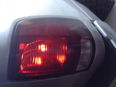

So I ordered some JDM ASTARS 3157 led's....mind you, I still have my oem tail housings with some VHT over them.
The good:
They fill the housing with more light.
They come on immediately being led's. No slow delay in and out.
The not so good:
They give taillight out message (I personally am ok with this because I know they aren't out) also it's for the time being until I get bored and order new led's or Spyders.
They aren't but maybe a lil brighter than the oem incandescent bulbs.
So, overall I would not recommend these... But here's some pics....

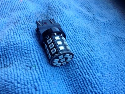

I believe you are getting the code because you don't, unless you stated it, have an inline resistors and/or capacitor/decoder. The tails from Spyder or Venom have them built in so its just plug and play...
Rzrman328
Rzrman328
Aug 25, 2014
5,808
3,152
The treeline
Ya I'm searchin around right now to see if I can find some on eBay/Amazon.
May just throw my oem's back in for time being.

These are some but there are many more out there. I like the decoder ones, they look like a black box...
