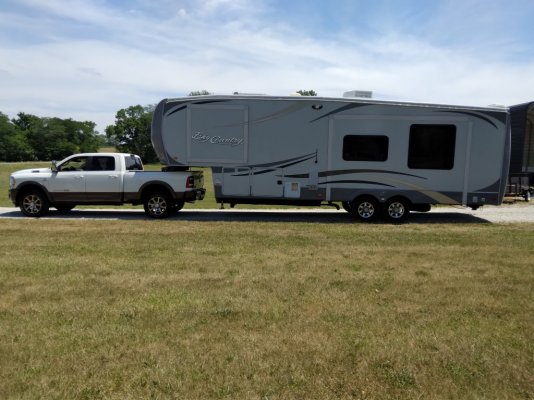

I just down sized this last summer. Went from a 8 foot bed (3500) to a 6 footer (2500). Ended up, almost all new fivers these days, have the 88 degree radiused front caps on them. So accordingly I did not require a slider hitch. So the crew cab truck with a 6 footish bed is 2 feet shorter in length...its 20 feet long.

Wow you can tow that beast with a 2500??? How long is it?
