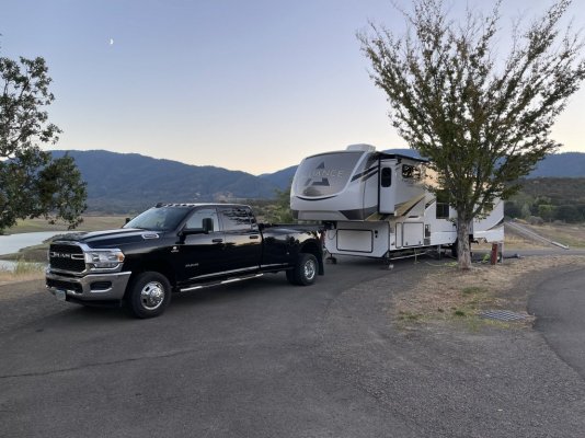

I can relate to your struggle. Earlier this year we took delivery of a 5th-wheel with 16,800 GCWR. We really wanted a SRW for all the reasons mentioned here. In the end, having had too much trailer for the truck in the past we decided on leaving plenty of buffer in the weights and capabilities and got a DRW. We've not been sorry at all. We full-time in the 5er and travel around the country mostly staying ahead of extreme temperatures and typically settle down in AZ for about 4 months in the winter. Probably 8000-9000 miles of towing. Having that extra stability has been a game changer, especially in the mid-west in strong crosswinds. That's our experience and I won't tell you what your best situation will be. That said my 5' wife drives that dually like a boss! :cool: There's a great spreadsheet at this link to help calculate the numbers. GVWR & Payload Calc.

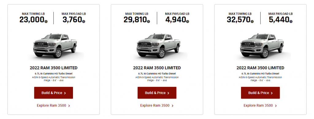

Ram's website is a little screwy when looking at payload and towing. I could be wrong but that center one has the numbers for the DRW. the SRW option is the on on the far left.

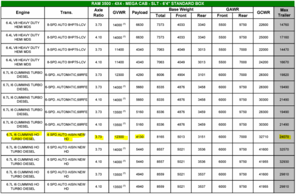

Yes, my bad. Here is what I actually have. Payload of 4130 lbs, and Max Trailer of 24,070 lbs. In that chart below, anything with a GVWR of 13,500 and above is a DRW:
Your actually going to be lower then those numbers, especially in the payload. That chart is best case numbers on a slt. Every option on your limited will take away from that (a lot more then you think)

Right, don't trust the chart! Get the VIN number and plug it in here: https://www.ramtrucks.com/towing/towing-guide.html#/landing/bytowing . This will give the numbers for the specific truck in question. I used this a lot when I was shopping because most dealers seem to provide the VIN number in the listings on their web sites. When I got to the dealership to look at the truck I was interested in, the first thing I did was to open the door and look at the sticker to confirm it was the same as I got from Ram's look up tool. On the 2500's in particular its amazing how much variation there can be. My 6.4L Bighorn has a payload of 2974 but an identical truck with the diesel is only about 2200. There are some configurations like a Limited, Megacab, diesel that actually had less payload than the Sierra 1500 I was trading in.

That's better than mine. I have a stripped out 3500 Tradesman SRW 4dr, Cummins HO, 3.73 rear and the door sticker lists the GVWR as 11,800.
