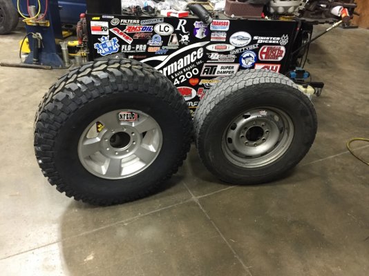

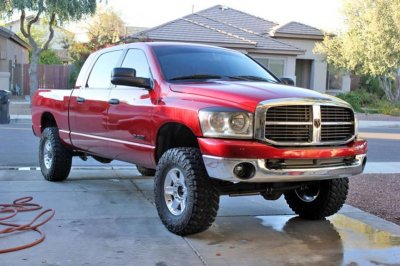

When I had my 07 Megacab, I put on 17" 4th gen wheels. Discount put the tires on the 8" wide wheel, but had to call Nitto to get approved.
Later on, I wanted to do the same and they would no longer do this as the tire on a 12.5" called for a 9" wheel. Would cause the tire to bow out and cause issues..
Now, thinking about it, I could see that being an issue.. but if it's 9" wide.. you shouldn't have any issues..
Also, you could just go to some place that mounts tires and doesn't give a darn what they put them on and be set..
I told Discount I'd sign a wavier! haha they said no.. But again, they are only doing that for the safety of their customers and covering their butts..
