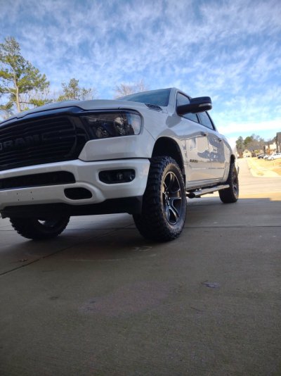

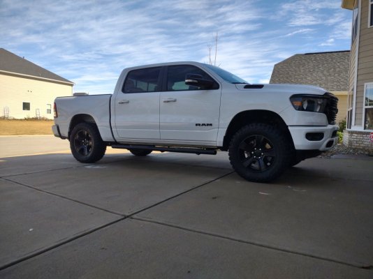

Hey to all. New to the site but I researched this post and could not find the answer. Hoping me posting helps someone else out. I have a 21 ram bighorn 4wd and recently put 35x12.50x20 MasterCraft courser mxts on it with the rough country 3.5 inch lift and leaving kit. The setup currently has 1/4" spacers on the front and there is absolutely no rubbing issues. At least with this setup there are ZERO rubbing issues even at full lock. Hope this helps someone else like me. IMG_20220218_112338355_MP.jpg

Sounds about right. I ran hub centric spacers on my 2014. Running the same tires I would have slight rub without at full lock.
