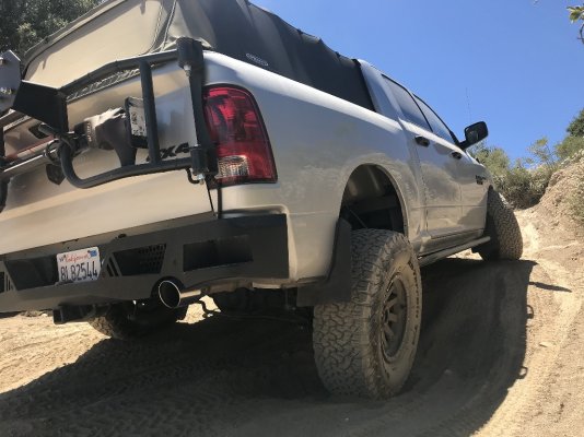

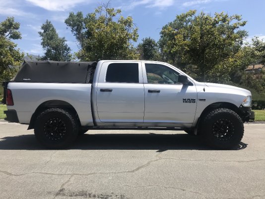

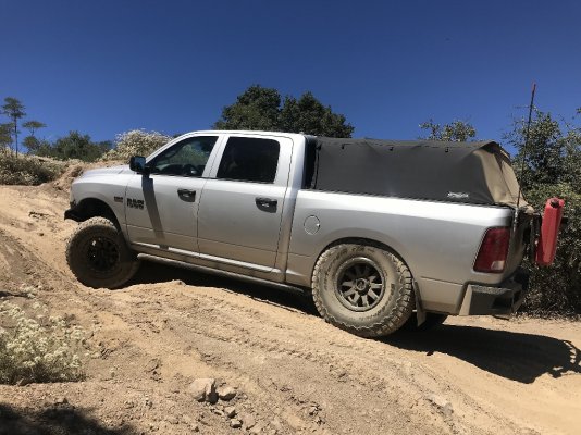

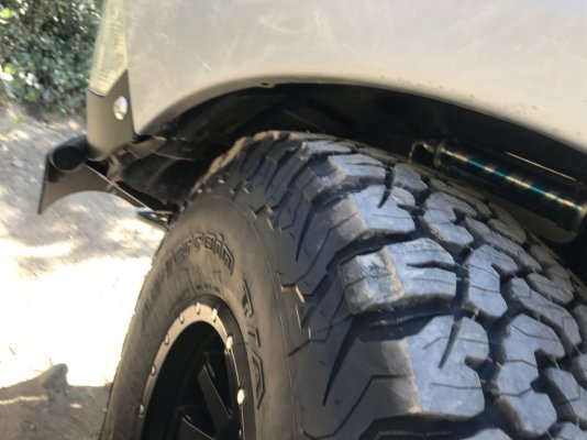

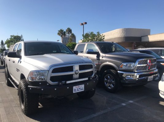

I’m running and offroading 37’s on a 2.5-2.75” lift with Kings coilover and shocks. You'll want to remove the factory front bumper and the plastic fender wheels in the back. I haven't touched the front fender wheels but had to do a little fender lip massage. I'm also running higher caster in the front 4.5-5* which will requiere aftermarket offset control arms.
Tires are BFG KO2 37x12.5x17 on Raceling clutch 17x9 wheels with -12offset. Keep in mind KO2's are prob 1/4-1/2" smaller than the Tires you're looking at so your experience might be different.
These are prob one the lightest 37's you can run at 69lbs each , wheels are 26lbs each.

Cosmetic rub here

but Nothing full lock in the front
