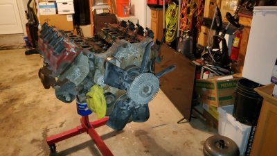

So I just pulled the donor hemi out and have it sitting in the garage right now. Gonna be a slow process to build this engine the way I want to and the engine is blown for sure. I found piston rings inside the intake manifold, so I'm excited to see what the inside looks like lol. Well I found a edge torque converter behind the engine, dont know much about the after market torque converters. Dont know how to tell what stall it is or anything on how it was built so any info would be greatly appreciated. Now here's some pics, tomorrow I'm yanking the harness out and then selling the shell

See if it still has a sticker or numbers, anything identifiable so you can contact Edge to ask what it is. Worst case scenario you can box it up and send it to them, they'll be able to tell you what it is and open it up to inspect it if you think you might wanna use it. They can also alter the stall speed if you want something else.
