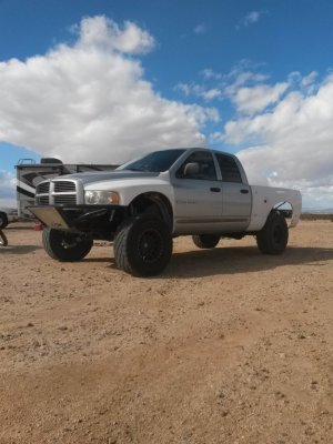

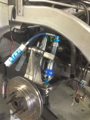

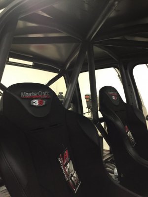

I have a third gen that's caged front to rear, strapped at 18". The fronts running a 2.0 bumpstop, 2.5 C/O and a 3.0 bypass. Rear is spring hung with deavers and a 3.0 bypass and 2.5 bumpstop. LSK built the front end and cab cage, a buddy helped with the rear. Its getting ready to be sent back to LSK to have the rear linked and a 9" put in. Be ready to spend around 15k for the front end... Dont think LSK has it up on the website, you'll most likely have to call and ask them about it.IMG_4397.JPGIMG_4851.JPGIMG_8567.JPGIMG_20151104_124858.JPG
