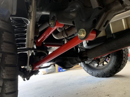

There are a million threads on the hellwig (rear) sway bar. A quick summary is the oem parts are light and flimsy. The hellwig swaybar and core 4x4 are beefy. Hellwig has stiff and soft settings available. The core 4x4 control arms eliminate wheel hop. We like to pair them with a new track bar and swaybar end links. This makes the back of the truck feel like it’s riding on rails when hitting bumps and train track crossings etc.

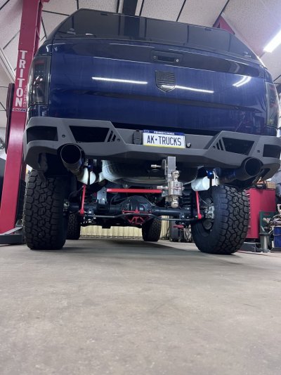

I'm good with that beast. Fast enough. I am thinking about the sweet rear end package you put on @Adamcr68 's awesome ride. That looks like my next trip out to see you and your ultra clean shop.
It’s ultra clean and drastic improvement
