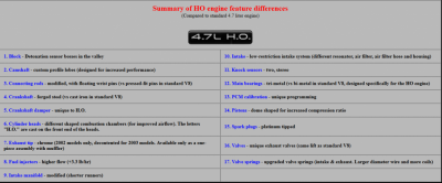

And you won't lol. You need a factory HO crank. Rods and pistons you can sort out later, but that's what you have to find. HO cams are nigh impossible to find nowadays but the 2008+ cams work in the older heads and are similar. HO heads are better than your stockers. The 08+ heads are better too but they are twin plug ignition so there's that pesky problem of figuring out how to fire the second one properly. Of course you could always buy a reman HO engine (as long as it truly has all the correct HO parts in it) and go with that. Would probably better as a whole since the whole engine was revised a bit (this is the Jeep summary, the only Dodges they made it into were some later Dakotas):
HO crank p/n is below:
