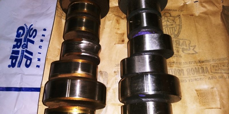

I have replaced the coil pack and plugs. Now the lifter is tapping loud and the # 4 cylinder is misfiring. The compression is fine on it. Any help?
Well Hate to say it but you either got a Collapsed MDS lifter or the Hemi lifter roller eat lobe off cam shaft. I hope it is just a lifter but knowing the Hemi I have been there myself you more than likely will be doing cam and lifters. Tear down is the only real way find out which. mine was # 6 and mine is non MDS. and compression is fine cause one valve is not opening normally the Intake valve.2.jpg
