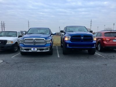

I don't have a suspension lift.... I do go off road ( now and then) and have had no issues, but I'm not twistin' my suspension all up. I have bilsteins set at 2.8, 3/4" TGC spacers on rear and 1.5" zone body lift. 35" BFG KO All Terrains works just fine... 4" total for less than half the price of a suspension lift

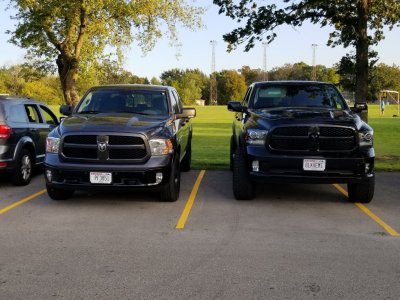

6in vs stock

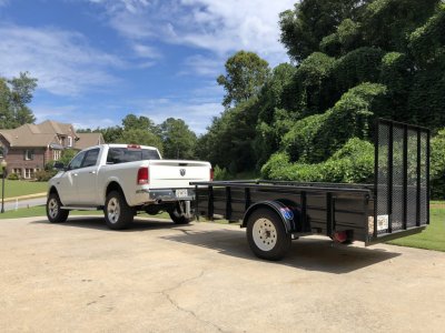

Man that looks exactly like what I'm after! :favorites13: Nice ride and wheels! What offset are you using?
Those are factory 20x9’s. Back in the day (2012 iirc) they were first available on the Laramie Longhorns, then a couple years later on the first Laramie Limiteds........now on the Harvest Editions. Seemed like they’d “disappear” for a year or 2.........always been a big fan of this particular factory wheel!

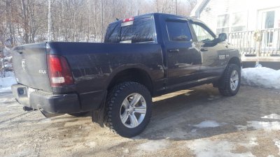

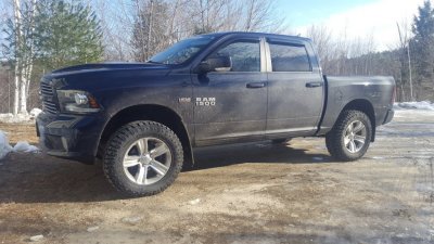

traded my 16 quad cab express for this 14 sport crew cab. has RC 4" lift, mopar cold air intake and borla exhaust. stock sport wheels with 35x12.5 duratracs. not too bad getting into and out. can load 2 car seats no problem. power steps would be nice though. but not a deal breaker. perfect combo if you ask me. 41.5" ground to bottom of wheel well in front, 42" in rear

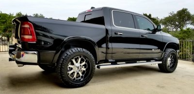

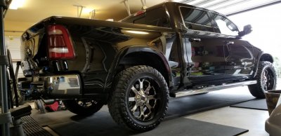

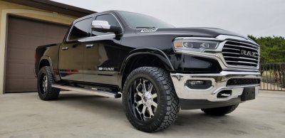

Here is my wifes 2019 Ram 4x4 Laramie Longhorn. It has a 3.5 inch lift, not leveled, 22 inch wheels, 35x12.5 Nitto Ridge Grappler tires. 20181119_140556.jpg 20181119_143622.jpg 20181119_140556.jpg 20181119_143622.jpg

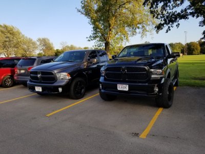

Wait, so what is the total height of your lift. 4" ?
Here's the thread with stock height and then bils/body/tires: https://www.ramforum.com/posts/1809943/
short version: original measurements:
Before ground to fender straight up center of the wheel
LF: 36.25" RF: 36.75"
LR: 39 RR: 38.5
My fender measurements are now 41 3/4 front, and 42 1/2 rear- both left and right are the same.

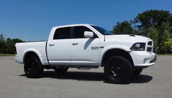

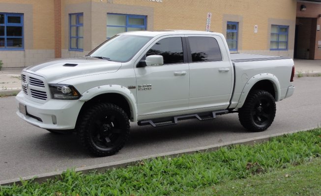

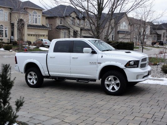

I have a 4" Superlift kit on my Ram and this year got Bilstein 5100's which I set at 1.4".
Here is mine new at dealer before delivery.
Mine sitting next to the identical model with a 6" Superlift kit.
4" lift before Bilstein 5100's (still has slight factory rake)
Winter mode with factory Sport wheels
After Bilsteins installed
