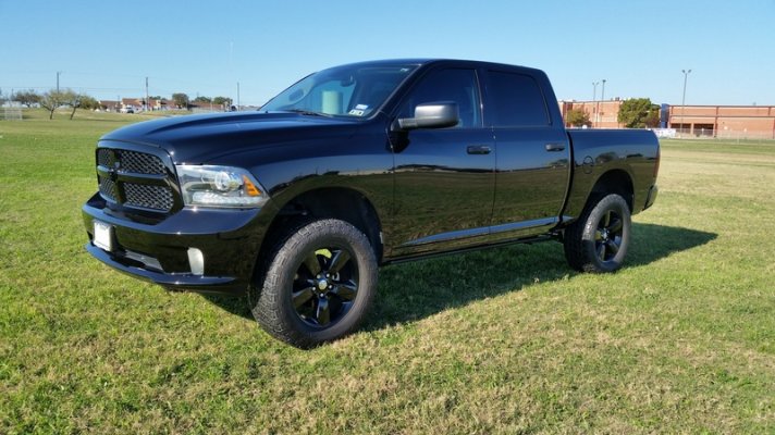

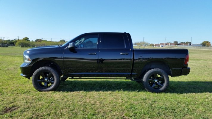

Just to give you an idea
2014 1500 4x4 Express - stock wheels, no wheel spacers & 295/60r20
4" Superlift with Bils set at 1.4" (only about 5/8" of rake)

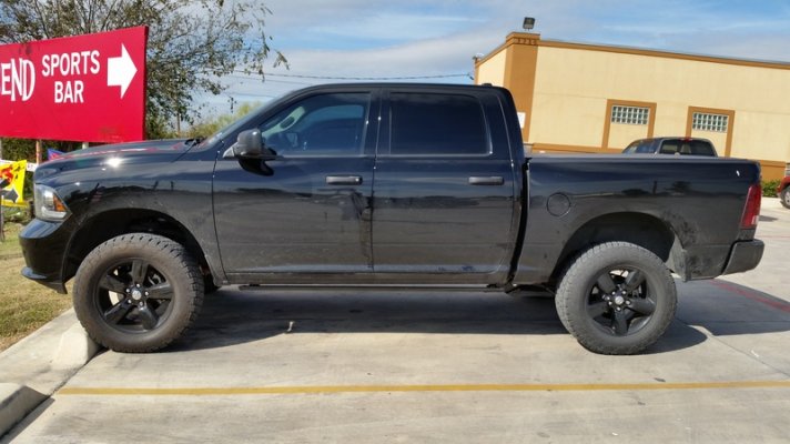

Sorry, the sun was not in the best position to see the gap between the fenders and tires. Here's a better pic to see the gap, but the truck is filthy
