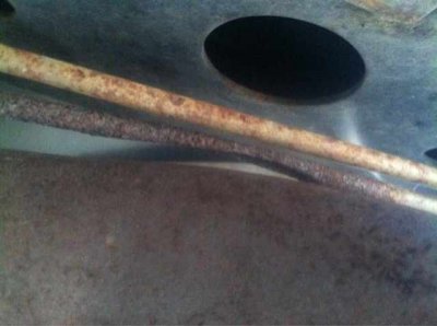

I found that one if the metal lines heading back to the transfer case had rubbed almost completely into. I was able to cut the lines back and braze in another piece of line. If it ever quits raining I will post some pics of my repair.
