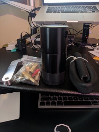

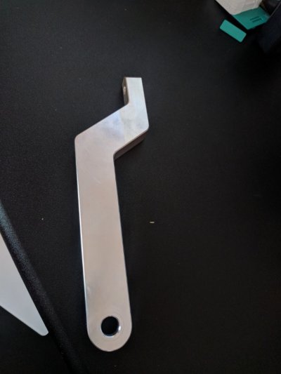

Hey all. I just got one in that I ordered from eBay. Quality is very good and am so far happy with it. Although mine was not $42 bucks, it was $86, including shipping. Everything installed great. Glad I could save a few bucks, I went with the black one and if I had gone that route with the Billet one, it would have been an additional $25 bucks plus a longer wait for delivery.
Here is the link to the one I got.
https://rover.ebay.com/rover/0/0/0?mpre=https://www.ebay.com/ulk/itm/192317901800
Here are some pics of the goods.

whetrick1

Did you mount it with the spacer on the outside of the catch can mount.
Yes I did, also had to had 2 washers as the engine bolt was bottoming out.

Well on mine the spacer went on the inside between the mounting arm and the head for the wires to run between the head and the mounting arm.

If you blow this pic of mine up you can see part of the spacer and the wire bundle that runs between it and the head. 2e53ea51f72948e106d751d16cdae223.jpg

Same one I installed. Like that comes with everything and quality hose. Also had to add washers to the bolt.

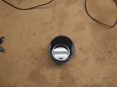

$42 catch can. 1/4th full. About 4k miles.IMG_20180320_181919.jpg

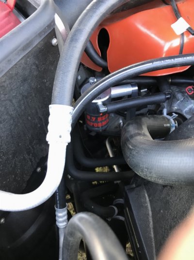

For those who have the Amazon catch can without a Z-bracket, where/how did you mount it to?
I see a couple pics where people clamped them to the A/C hard line....Im not sure I like that idea (will it cause the line to break eventually?)
Also curious if I should worry about voiding a MaxCare warranty because of the catch can.....
Clamped mine to the ac line and no it will not cause any harm to it. I think I have my writeup with pics on page 2 of this thread. I like where I placed it, as it is easy to get to, it does not budge at all and I don't even need a step stool with my 6" lift. However, the ac line location I used may not work with a K&N CAI or any other CAI that needs that area for the mounting arm. I have S&B, so no issues.
