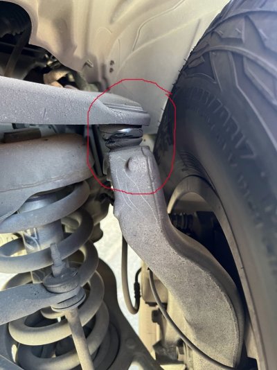

I just have some questions about suspension and what would be the best way to fix this whole situation.
I wil also attach some pictures for better clarification.
I purchased a lift/level kit maxtrack 2.0 with fox shocks and springs.

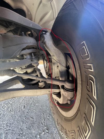

I noticed that the controll arms are wearing out and also not sure what you call it but the plate that is holding the wheel is at a angle that attaches to the controll arms.
I also notices that when I go over speed bumbs or cracks in the road or even reflectors that the rear ends wants to just give out especially around a turn.
Thank you for the help !!

Based on how dry and cracked the sway bar link bushings are I’m guessing it’s mostly age. Same for the grease boot on the upper ball joint. Also the spindle is not straight to begin with unless you are meaning something other than what I’m thinking. Mine is 4wd but still same for reference. Not sure what you mean by rear end wants to give out. Any better details?

It was installed when I had about 70k on it so roughly about 3 years ago. I currently have 125k on the truck. My concern is the amount of angle it puts on the spindle. Is it to much stress on it? I know 4x4 vechiles have a different setup then we do. I dont mind changing out the parts to fix the issues.
Correct , I am talking about the spindle . Would i need to get a different spindle since it has a lift on it and causing more angle stress on the balljoint? I would like to replace the swaybar links and the other components that are a lot better then stock.

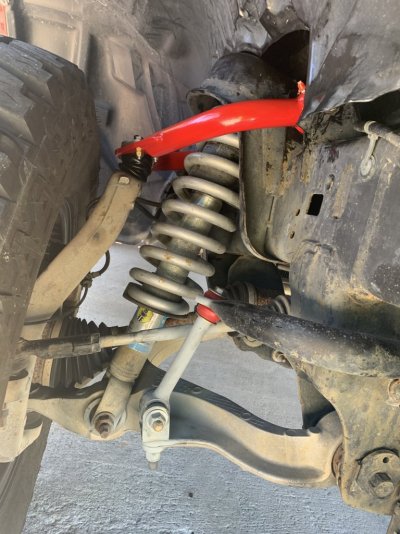

The spindle is fine. If you are concerned about the angle of the ball joint you could get a new upper control arm designed for lifted trucks. Maxtrac sells one. It has nothing to do with the spindle. Honestly I would look at the maxtrac spindle lift kit instead of the 2” spring kit you have. It’s a lot easier on everything because it reuses all the factory parts and just changes the spindle which keeps everything at factory angles instead of pushed down like yours is. There is nothing wrong with your setup. Each has different pros and cons.

The spindle will lift you more if you do not go back to stock springs. You could get away with just doing the upper control arms from maxtrac and be fine most likely and not do the spindle. As stated each setup has its own pros and cons.

Buy the maxtrac control arms so they have a better ball joint angle instead of mevotech. The stock sway bar links are better than mevotech and I think you can just order bushing for it instead of replacing the whole thing. And you can order the rear fox shocks from maxtrac to match the fronts Here. Also if you want heavier load springs look into tuftruck coils. Here.
