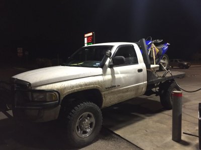

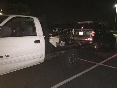

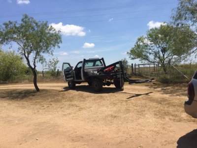

Pics just so you can see it over the years.
