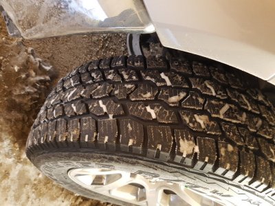

cooper atw works for my truck on ice and you don't have to remove them in summer they are a true 4season tire mine are 275/60/20:happy107:
