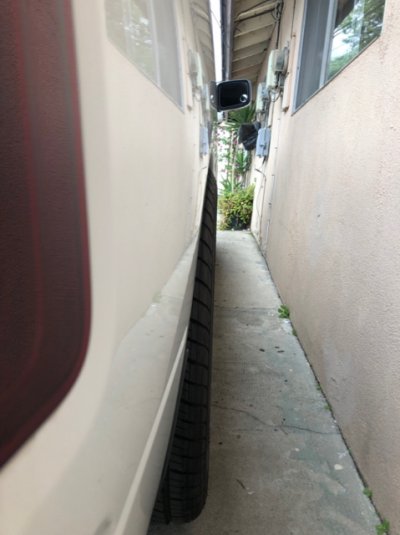

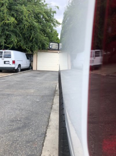

Anyone know why my rear right tire sticks out more then my rear left?, is it cuz of alignment? I recently had my truck dropped

Hard to tell without seeing a before pic - mine is a 4x4 so our bar actually goes the other direction. But lowering will cause the upper panhard bar mount to be lower, thus forcing the axle over due to fixed length of the bar. Most kits will suggest an adjustable bar be installed or provide a relocation bracket of some sort - did your kit say anything about that?

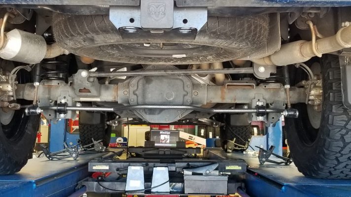

There is some movement built in - when the suspension flexes the panhard bar will move the axle left/right a minor amount by design. But if you are off center at ride height then you will need to accommodate that in some way, typically with an adjustable version with heim joints so that you can set it specifically as your setup requires, such as:
http://www.moes-performance.com/Spohn_Performance_Adjustable_Rear_Panhard_Bar_p/d09-1500-104.htm
I actually have a similar issue, sticking out a bit more on the pass side after installing Icon Lift coils (as 4x4 bar goes opposite of yours, hence lifting pulls axle to pass side slightly. Lowering your 4x2 is pushing your axle to pass side slightly.

I actually didn’t install the 5/7 drop kit myself I had it installed i was looking to see what the problem is so I can get the guy who worked on it to fix it , but i do believe it needs an adjustable bar , or what can I tell the guy? It actually is my first time getting a truck dropped so I don’t really have the knowledge

Yeah just tell/show him that you rear axle is off center after the lowering kit install. They will know what the issue is and how to fix it. A 5/7 kit is pretty extreme, I'm surprised it did not come with something to accommodate the change - typically directions to drill a new mounting hole, or a relocation bracket, or upgrading to an adjustable bar. Was it an IHC kit?

This is the relocation bracket (circled). Make sure it's installed...it probably is but double check.
You will need to be prepared for the installing shop to say something like "That's as close as we can get it" or similar. If that's the case, call IHC and confirm. Worse case you may have to add the adjustable bar. It might be a case of it will center at 5" but if you go 7" it will require changing the bar, or something like that. See what ICH says after you talk to the shop.

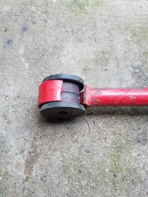

I got a Belltech 964hkp kit, it's 2x4 but Im running GF 2" rears. 2x4 is a little to low for me, I tow a lot and don't like the sag.
What's the backstory on that?
I drive "kinda" hard, it broke, so I upgraded
