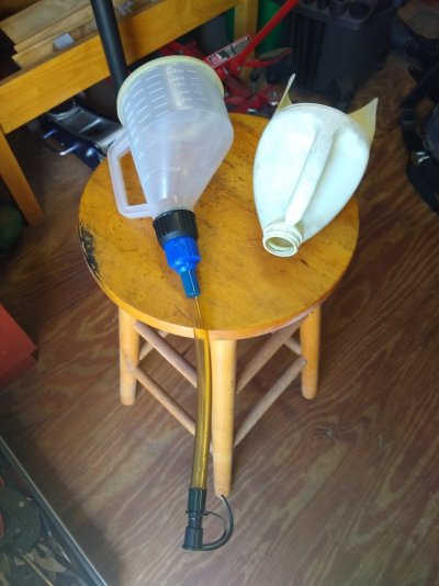

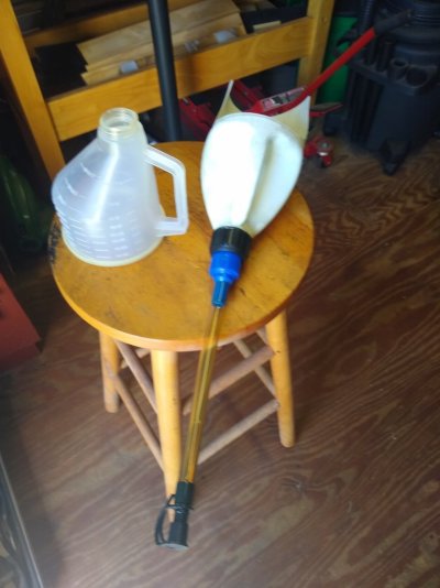

I have already been using this method for quite awhile ... I use an empty half gallon used Clorox bottle because the smaller diameter fits between things better ... I purchased a oil funnel/tube and attach the tube with the screw on shut off/on plastic valve to the old Clorox bottle ...
