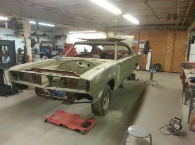

Ahhhhh... Another 1st gen Charger fan. I have a 67 I am in the middle of a restoration myself with. Mine had a 383 when I bought it but now it has a 495 stroker. I still have a year to go (I hope) to finish it up but it's coming along.
This will be the 4th restoration I have completed and it has been the most challanging. I am sure you have discovered, unlike the 68 Ram Air Firebird, 70 Nova, 80 Jeep CJ-7 that I previously restored, almost nothing is available for this car in the aftermarket.
