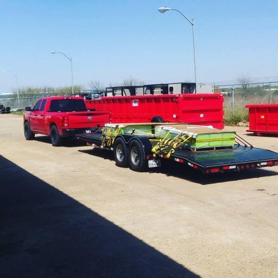

I got 11.0 on the EVIC going from Dallas to Galveston with that 10k load, averaged out to 13.8 hauling the trailer back home (24ft all metal car hauler). This was at maybe 100-500ft elevation and pretty flat roads, 600 mile round trip.
