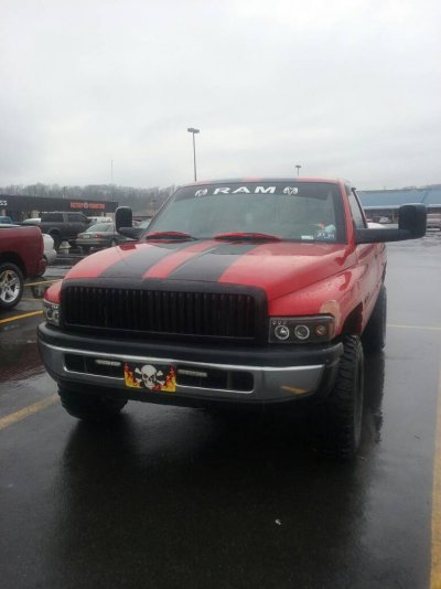

Here's mine

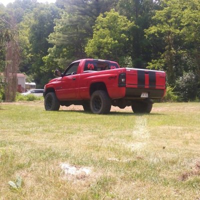

Another one

Long Arm :waytogo:

I might check that lift out ! I'm diggin that front bumper man
