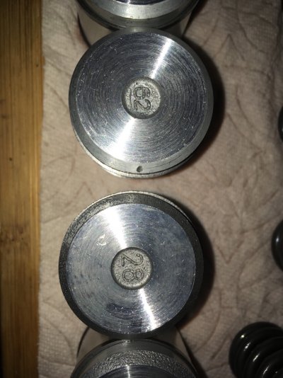

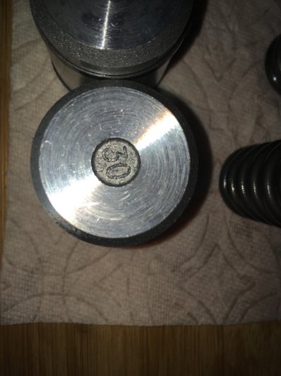

So I may have turned the VB upside down trying to get the switch valve out and dumped out all the pistons. Does anyone know the order based on the stamp on the bottom that these go back in?

Look for a mfg stamp or numbers to cross reference on it, maybe you can search the great wide web for a diagram. Gl bud.
Or if you are near a trans shop, I'm sure they would put it back together quickly. At what cost? Not a clue.
I know there's some good transmission guys on here and I'm sure they will chime in and help you.

TransGo says all pistons are the same and only spring placement is key.

They do that most times in case of failure. They can look back at runs of same cast number and see if one of the casts is bad.
