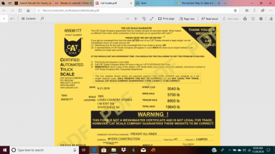

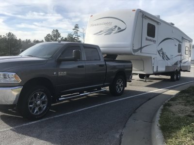

I tow a 5th wheel with my 2500. My 5th wheel is only 10,500 dry. My pin weight is 1950. I'm over payload by 700lbs. I'm under rear axle weight by 300lbs.
Pin weight on a toy hauler the size the OP is looking is 3K+. That would be over payload and axle weight on any 2500.
The CAT scale I attached is my rig, fully loaded with the dogs, me and my wife, truck full of fuel. We don't pack anything in the truck, we pack the camper. IMG_1397.JPG Screenshot (1).png
