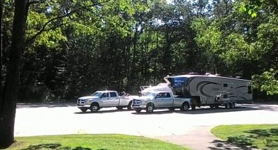

The only physical difference between a 2500 and 3500 truck is the rear suspension .
This just is not true.
Even if the transmission is the same 66rfe, the 3500 has different shift points, more aggressive tow/haul up and down shifting, more aggressive exhaust brake, different brake pad materials, different front spring and shock rates, different front axle weight ratings, different size rear pinions, different gear ratios, and the list goes on.
Yes, they share many common parts but to say they are the same except for rear suspension is just not accurate. Bt before you tell me i dont know what im talking about- I currently own a fleet of 6 trucks, 5 one ton duallys: 2014 big horn, 2 2015 traseman, 2 2016 tradesman and 1 2016 2500 laramie.

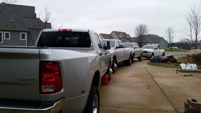

Below is a photo of 3 of them plus my own 2500 parked in my drive recently for the repair shop to come pick up for maintenance.

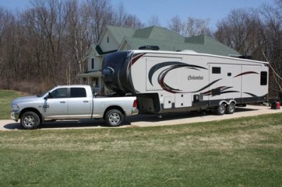

Ultimately, it comes down to what your comfortable with, and how much you're willing to carefully pack your stuff so it shifts your weight towards the axles.
I pulled my columbus 365 (1980 dry pin weight, 2354 loaded pin weight) with our '14 2500 big horn until I needed a heavier truck for my business.
Obviously, the dually pulls it with stability, but if I'm careful loading the camper I'm very close to payload and within ALL other weight ratings of both the vehicle and the camper. Some by alot, some just barely.
I'm not advocating towing overweight, quite the opposite, but owning a dually can be very expensive.
Below- the bone stock '14 2500 with a mostly loaded camper.
The dually with fully loaded camper. The dually with a max loaded camper and a work truck my wife pulled our boat with last summer.
