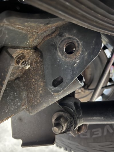

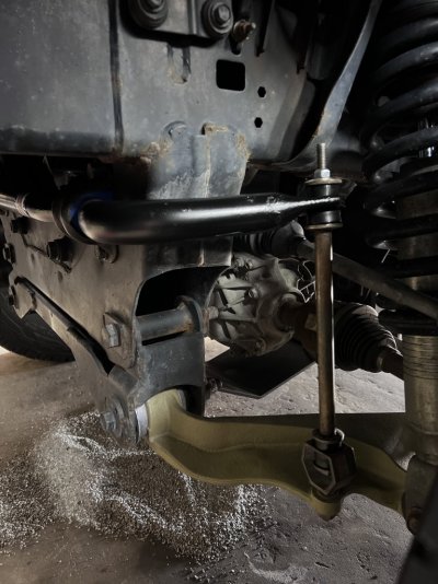

The original (master tech at a ram dealership) did not install all the hardware that comes with the zone kit.
There were 2 different brand angle correcting brackets in the rear. The front tie rods were shot, swaybar front and rear needed new bushings 96FC740D-016B-4AD4-ACC5-3B11A17BD412.jpeg

B932C9AA-D4F4-48E1-83AD-3011467FFD3B.jpegHe did make it easy for me to remove it as it, is unnecessary with the procomp rear box kit
