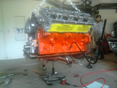

Ive got a 6.1 cam in my truck and it didnt have as much tq as i was expecting but my motor is built for more mid and top than anything. but then again my tranny has been screwed since the first time i fired on it and is in the process of getting built so i can actually feel what the motors got goin on. the cam helps produce major horsepower startin around 3800 it pulls super hard with a slipping tranny and pulls hard all the way to rev limit. the engine spec is: 5.7 block with forged 6.1 crank and rods, coated 5.7 pistons, 5.7 heads machined for 6.1 components, shaved heads, and the 6.1 cam. ive also got gibson stainless shorties, offroad y pipe with the cat, flowmaster super44 extreme and a vararam hemi under glass rai on it with stock tune still. after i get the tranny built ill have to try the degree advance and see what that does for the bottom end.

yeah i couldnt find alot of info or comparisions on cams when i had the motor built. if i dont like the lowend after i get it on a dyno to tune it then ill prolly switch it out for a low to mid cam or maybe just have this one worked. i was wondering if anyone has done the dgree change with this cam and if it helped out the bottom end any?
Rampage, from what I have read 5-6 degree's advance gives the 6.1 some dig. As you are 03, I hope you keep us updated. Do you have have something piggybacked to manipulate the MAP? It shouldn't be needed, but since you are having trans issues I thought I would ask as I believe there is a relationship. Welcome to the forum....

ill for sure keep you all updated. your right there is a relationship between the two but that isnt what caused my tranny problems. too much motor for an already worn tranny. the stock hp rating on a 545 rfe is right around 440 hp and i smoked it a little the first time i stabbed into it and it started slipping and just eventually got worse plus it needed a stall for the cam with the bigger tires so i burnt up 4th driving at highway speeds where it would constantly shift back and forth to lock up. ill have to figure out how to do the degree advance cause ive never done it before and ill for sure let you guys now what she does. tranny should be done in about three more weeks or so i hope.
Rampage,
There is an adjustable timing kit here Camshafts and the other suppliers also have them. The basic two types. One being a OEM spocket with a offset plug of different degrees placed into a oversized dowel pin hole. The other is keyways cut into the spocket for different degrees. As for large tires. I would suggest gears to remedy that problem. A higher stall coverter is best for just letting the engine move into a stronger torque range. At highway speed the TC should be locked otherwise there will be a lot of heat generated. Anyway that's my 2 cents.
