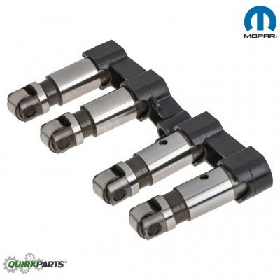

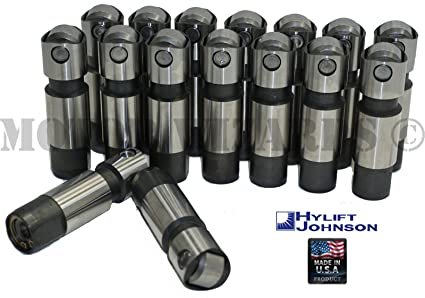

I wonder if the piece holder the roller pin is flexing. I bought some USA made Johnson Hylift lifters for my Hemi and they are solid around the lifter roller.
Johnson lifters Hemi
Oem Hemi lifter.
Did you replace the cam too?

Looks just like a wiped out flat tappet cam.
I’d wager the roller seized.
I Don’t think roller cams are THAT picky about oil, if they were, I wouldn’t have gotten over 200,000 miles out of my 08 hemi with the cheapest non synthetics I could buy off the shelf. Hell. I probably added the odd quart of used oil when I was in a real pinch. Leaky exhaust manifold yes, cam lifter problem, never.
08 hemi didn't have MDS lifters which in my opinion is failing and taking out the valvetrain with it.
I'll be swapping to a non mds lifter before 100k hits the clock.
My hemi was mds, my brothers 07 hemi was Mds. 06 was last year of non mds.
But I’m not a mechanic. I just turn wrenches.
