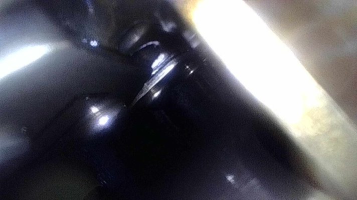

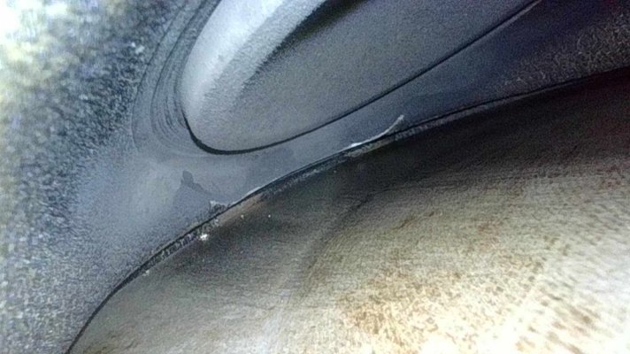

Cylinder 6 seemed to be the worst offender for the misfire so I put a borescope in the combustion chamber and it appears there was no valve-to-piston contact so I do not suspect any bent valves or pushrods at this point. See pics below.

Exhaust valve:
Intake Valve:

Then it occurred to me that the valves may not even be in the correct positions (see previous pictures of cylinder 6). The piston is at near TDC which means both valves should be closed on compression stroke, or both slightly open during overlap on the end of the exhaust stroke. That intake valve is clearly all the way closed.

In your pic, the intake valve is closed, bit the exhaust valve is open.

Pulled the valve cover on the passenger side. On the first checkout, all the push rods were seated in the rocker arms - intake and exhaust. There was no free play on any of the exhaust rockers except cylinder 2. This is odd as 4, 6, and 8 should not have exhaust valves open/opening all at the same time. An important note too is that cylinder 2 had no misfires (see video above of VCM scanner).
I then pulled the exhaust rocker assembly nice and slow, loosening each bolt a couple turns at a time. Felt like there was spring tension being relieved little by little meaning I don't think the valves were stuck, but rather spring compressed by the rocker arm.
Here is a pic of cylinder 6 exhaust valve (previously seemed to be stuck open) after removing the rocker assembly - Valve is fully closed. I put the scope into each cylinder to confirm that all the exhaust valves were indeed closed with the rocker assembly removed. Based on this, I don't think I bent any valves, at least on the passenger side.
