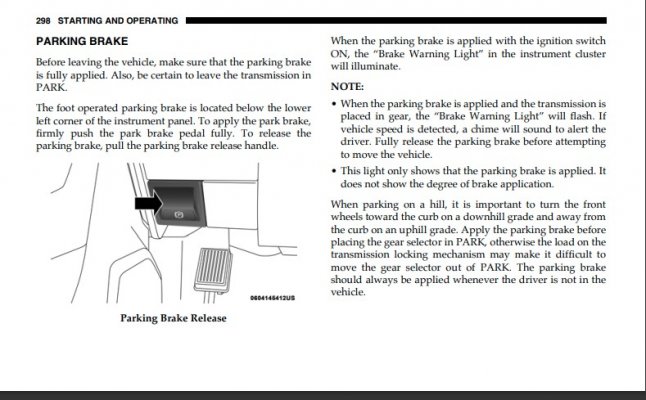

The E-Brake needs to be set when you are happy with your parking spot
Then move your transmission into your Park position & lastly remove your foot from the brake pedal.
When you start your vehicle back up, depress the Brake pedal, shift into gear, then release the E-brake
This same method works on most vehicles, even semi trucks & Heavy construction equipment.

More than likely it is exactly what everyone has already mentioned. When you park on the incline and put it in park the truck rolls and basically puts the trucks weight on the park pin which makes disengaging it harder than it should be giving you that clunk. Again as mentioned, when you park on an incline put the parking brake on BEFORE you put it in park so it puts the weight on the brakes and not the transmission. That's exactly what the parking brake is for. When you want to leave, start the truck, put your foot on the brake then either release the park brake or put it in gear with your foot on the brake. I've never had a problem doing it that way on any vehicle I've owned

This is a practice I share with my wife and any family that’ll listen when they park at my parents house. Pull up, parking brake, neutral to let the brake catch the vehicle, then park. Zero strain on the tranny at that point. Then when you leave, d or r, release parking brake, and away you go.

Then come to a stop, keep foot on brake, shift to neutral briefly, shift to park and let go of brake. The difference between your method and mine is that I don't have to touch the ebrake at all, but yes, shifting to neutral to allow truck to settle against brakes instead of transmission pin is the key.
I do it every time, regardless of hill or flat, parking brake is supposed to be used everytime anyway. And when it's done automatically for you, makes it even better.
