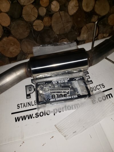

This is what I have. 2/10 louder at idle 5/10 louder at 4000rpm. 4.5stars, would buy again.
At 1500-2000rpm when the temp is below -25C in 8th with fuel economy between 17-20L/100kms it drones... louder with more throttle without downshifting. There’s practically no drone when the temp is warmer.
You will have to grind off the rear clamp on the stock resonator pipe. I also cut 2 more compression slices in both ends of the stock pipes.
