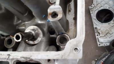

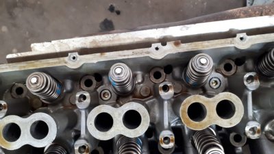

Yeah I'm starting to get really tired of seeing that check engine light starting to flash. Last year my truck was in the shop 4 times total. First time was the lifter problem, second was a bent valve. And these last Two broken valve stems. Anyway these springs will work in my 09 hemi? Just asking cause it says gen 3 hemi.
I managed to upload pics of the carnage. The pushrod was also bent. Forgot to mention that before.

I tried using the stock springs and I bent a valve a few minutes after they finished logging after the tune. They would work but not for 6300ish rpm I'm running at.
As for the mopar performance springs, if they will keep my truck from breaking down, I'm gonna getting them. They can't be more expensive than a broken valve stem, bent pushrod and destroyed cylinder head.
