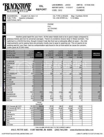

Just got my Blackstone Labs back on my last OCI using MAG 1 full synthetic 5W-30 in place of 0W-40. Just as I suspected, no increase wear or detriment to using it.
Just offering this as a data point and example. I am not advocating deviating from the OM recommendations.

Thanks hoot, i appreciate that. No you're not suggesting anyone not use the MS spec oil, but your results prove you won't hurt the 6.4 by not using it. I appreciate that because again, i prefer valvoline oil and I'd rather use their 0w-40 wt.
Legally, if challenged, i don't know that the oem could deny an engine warranty claim for not using their specific spec oil, so long as your running the right viscosity.
I think the Magnussen -Moss act may have a provision that would forbid them from denying it based on that, but I'd have to review it again. It's been awhile since I've read it.

Not trying to argue or shoot down what your results show, but using a different oil for one OCI isn't going to show any abnormal wear on a relatively new engine. Now, I dont think it'll cause any abnormal wear regardless but the results really don't do anything but piece of mind, doesn't prove or disprove anything. Ive always been an amsoil fan, used them on all my previous Hemi's with great results, quieter idle with less Hemi tick so Ill probably use them again, especially since its a qualified oil under MS-12633.

You have to set a baseline, then monitor any deviations from that baseline.

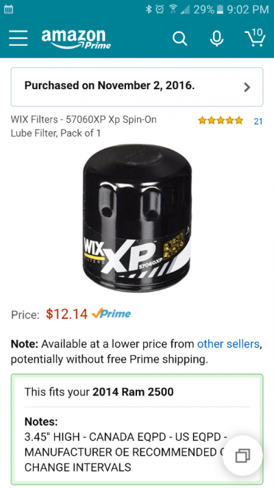

What would be the wix xp part number for the slightly larger filter. I am running the stock size one now but will be ordering my oil and filter soon. I run the amsoil. Only changed the oil once so far. 8200 miles on truck so far. Will have it 2 years in sept. 2017
