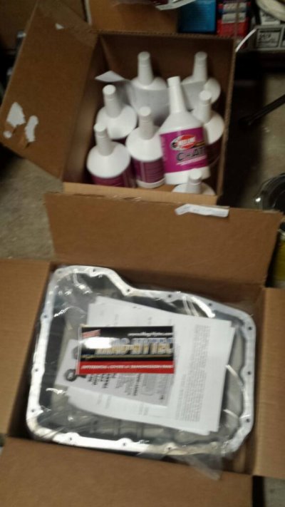

Ordered a MagHytec pan last night from the link @DILLIGAF posted a while back. Best price I could find for it...

Cool ! Post up some pics of the install Sir , I'm interested in this pan and it's P/N

Will do! Probably won't be until next weekend by the time I get the pan and have time to change it. This will be the third I've had the pan off my trans in the last month

Hope the Mag-Hytec pan goes well , no filter contact , nice fit and all .
I'm wanting to install a drain plug kit in my oem one , but I'd also like the extra fluid capacity and cooling finlets of an after market pan .
@Hemi395 , is the drain plug kit in the oem pan leaking or something ?

It's not leaking or anything, it's just I can see it being a problem in the future. You have to hold the bolt on the pan itself with a 3/4 wrench while you undo the drain plug and when you tighten it. Otherwise it spins in the pan and I can see that leaking after a while. I plan on doing a few drain and fills with TransMax before switching to C+ and I will be PISSED if it starts leaking with $12/quart C+ in it

Unbolt the y pipe at the manifolds, you will need the room to install the new pan :)

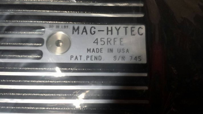

whats you S/N on the pan ? mine is 746
