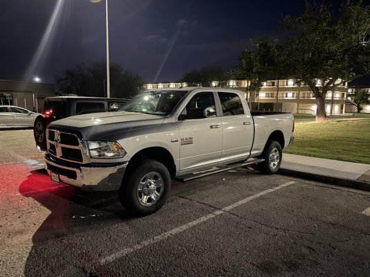

FD57E945-8CCB-458D-949C-CF8F9B5B1FD7.jpegNew to ram!! Switched from Chevy. I have a 2017 5.7 2500 with a 66RFE. My stock torque converter is on its way out and I’m wanting to change it out with a more reliable one. Not sure which new converter to get. Any suggestions?

Nice looking tk btw! Rams look great in silver.
