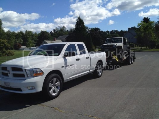

I wanted to post up about first time towing experience with my new '12. I took a trip from Boston up to Southern NH for a weekend of camping an wheeling with my Jeep. I'm pulling with a '12 Ram 1500, Hemi, 4x4, club cab, short bed. Max tow rating is 8,550, I've also installed an external brake controller. Trailer is an 18' deck equipment hauler, 82" between the fenders, dual 3,500 lb axle, 2 5/8" hitch.
I was fairly impressed with the power the Hemi delivered, it's a fairly apples to apples comparison with the LS3 GM puts in their 2500/3500 gas trucks. The 6 speed auto is pretty nice, but it's no 6L80 (also factory GM.) With 7,000+ pounds behind me (1,900 trailer, ~5,200 Jeep) the 1/2 ton Ram was extremely sensitive to how much/little I had the tongue loaded. To much on the tongue (the trip up) I experienced a decent amount of front end lift and the typical over and understeer problems that go along with it. Too light on the tongue (the trip back) and the trailer was pretty damn shifty, to the point I scared the hell out of a few Cadillacs in the lane next to me running I-495 at 80 mph. I had a few intermediate length pulls leaving the campsite and going to various different trail rides in the area over the 3 day weekend, and a few of those times I found a nicely balanced tongue weight. When I was able to achieve that, the Ram really pulled quite nicely. Outside of the sensitivity to tongue weight, I'd say it's pretty comparable to most 3/4 gas powered trucks (and I've driven plenty.) Also, averaged about 10 mpg running 80 mph highway and tons of hills on back country roads.
A few things I'm going to look in to for the future:
Transmission temp gauge, to keep an eye on things.
Possibly adding air springs to the rear.
Also potentially adding a sway bar system to the trailer/hitch.
At 7k plus, I'm definitely at the upper end of the Ram's capabilities, gotta say overall I'm pretty pleased. I almost opted to get a 2500/diesel, but ended up staying in the half ton market as I usually only tow my Jeep about twice a month. The additional cost of a 3/4 ton diesel just didn't quite make sense. Looks like I made the right decision on the truck, count me as another happy Ram owner.

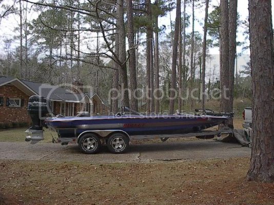

Get youself a set of in-coil bags first, they will do the job your looking for and cost around $100. You can even get fancy for a little more with a compressor and switch so you can inflate *** deflate on the move. I have the red ones on my 10' and they work perfect pulling my 18' enclosed total weight around 6k. With 15 lbs in them it would return the stance back to factory and now that Im lowered 4" in the rear it takes a little more like 20-22psi to do the same. Have the squat problem I believe is your trailer, an equipment tralier is made with a lot heavier beams than a standard car hauler, theres not doubt its gonna squat you down. Your sayin 1900lbs on the trailer seems light, my enclosed is heavier than that by around 600-700lbs. Shoot ill go so far as to say that my ram pulls just as good as the GMC 3/4ton 4x4 with the 6.0 gas motor did that I traded on it. Only difference Ive noticed is in the real hilly areas it can seem to lug a little, but thats alright because I can get 10 towing and 18 highway not towing where as my 3/4ton got 10 highway and 7-8 towing.
