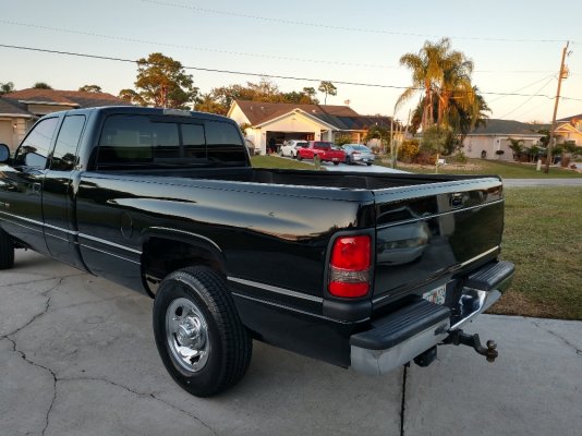

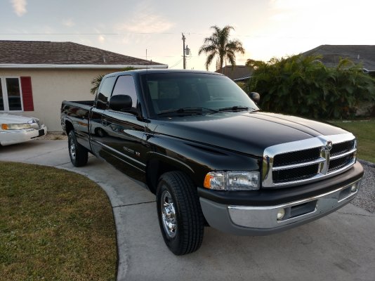

I threw the front end back together after ordering some missing nuts and bolts - installed new tie-rod ends, front wheel bearings, brake rotors, calipers, pads, and shocks too. Ball joints and control arm bushings were already installed a few years ago. I have the pitman and idler arms but I bent my puller trying to get the pitman off the steering gear. I'll let the mechanic take care of those. :Grin:
Got it insured and registered on Wednesday, and for it's maiden voyage I drove to the landfill to remove all the wood from the bed (1020 lbs!). It drove all the way to the top of the trash mountain with no problems. Only an occasional hesitation in shifting, completely randomly.
Looking forward to handing this thing over for the rebuild. He says he is going to look at the rear diff, too, but I think I might encourage him to just go ahead and rebuild it completely, or at a minimum replace the bearings and seals if the gears turn out OK. That and the driveshaft u-joints and whatnot.
Still need to get a quote for paint. Anybody got an idea of what a halfway decent paint job would cost? $2000 maybe? Not looking for a mop 'n' glo Maaco job, or show-car worthy, either - just something that will hold up for a while and look decent.

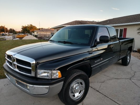

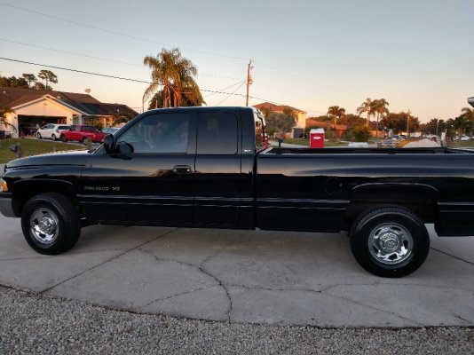

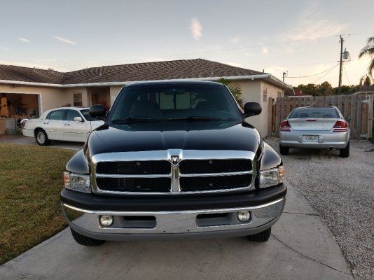

I just stopped by the mechanic yesterday. Engine is completely rebuilt, put back together and re-installed. Had to bore the cylinders .30 over and he had a difficult time finding a camshaft. The cam was basically worn down to nothing - to the point that the machine shop didn't believe my mechanic when he told them it ran and drove just fine before he brought the engine in. :Grin:
He cleaned up and painted the engine, intake, valve covers, accessory brackets, etc. As well as detailed/painted the frame and parts of the engine compartment that were going to be covered by the engine.
He's going to order the transmission now and soon enough it'll be ready for paint. I've been finding the emblems and other miscellaneous trim parts on eBay and LMC truck for when that time comes. It's going to look and drive like a brand new truck by the time it's done.
Sent from my Moto Z (2) using Tapatalk

Wow congratulation on restoring a memory from the past that's priceless, you didn't have to deal with any dreaded corrosion like us from the salt belt of the world, I have a Great new truck that I don't drive in the Winter because of this.

Wow. Your truck looks like that and you were concerned about rebuilding the motor.

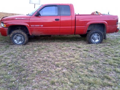

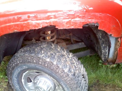

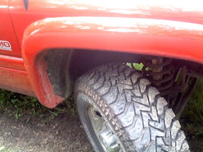

And that is the good side.
Fenderflares and red duct tape keep it good for the inspection man
Do wish mine was a longbed.
Thanks for posting your truck. It looks great.

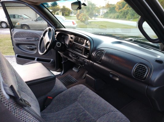

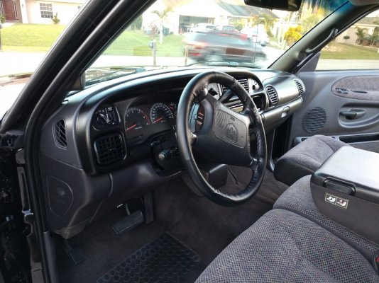

Thanks. It certainly didn't look like that from the beginning, though. the dash cover was completely trashed from the Florida sun, the paint job was in terrible shape, the front bumper plastic pieces were faded and damaged. The Evaporator coil was leaking, the blower motor had a nice little whine to it, the rear driver's side door didn't want to open. The front infinity speakers both failed and the head unit, too, so I had to convert the stereo system to conventional. I am very lucky that the body was structurally sound.
It definitely needed a LOT of work but I'm incredibly happy with the result.
Once the muffler gets installed it'll finally be rid of that pesky rattle at idle, too.

Wow, This is on my future chores list as well. Mine has 225K burns/leaks no oil or coolant. Only thing I've changed over the years is: Radiator, thermostat, P steering pump, Heater core and I think water pump "not sure on that one". Getting to that core was like working with an egg shell. Had to buy a dash cap and a few of the brackets that bolt dash to firewall have broke. Now dash bounces around on rough roads. Dam these trucks have a rough ride!! Did you replace the dash or were you able to salvage it? Any problems with the brittle plastic?
