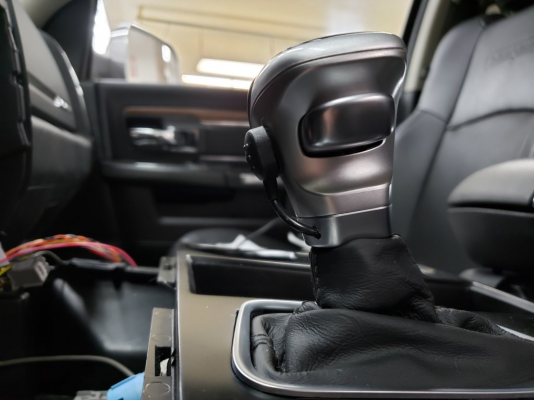

I finally got my manual shifting gears to work with a momentary SPDT toggle switch. Over the holidays, I removed my TCM from the valvebody, sent it to Russell to have him flash the Challenger Scat Pack firmware, and re-installed. He did have to send me a new PCS bin file yesterday to get it working, but I can now manually change gears and hopefully disable the OD lockout at higher speeds by manually shifting.
The Challenger firmware did fix a weird occasional 3-4 shift when reaccelerating after coasting where the engine would rev really high (relative to throttle) in 3rd and when it finally shifted to 4th, it would suddenly lockup/grab almost like someone with a manual transmission not rev-matching or properly timing shifts/dumping the clutch - I am assuming the TC was allowing a ton of slip (3600 stall) and then when shifting to 4th, it would suddenly lockup - I need to investigate and compare the tunes for confirmation and evaluate TCC OSS lockup in those gears. The WOT shift points also bring it closer to redline (392 car long block with small MMX NSR cam and ported 6.4 truck intake). I have heard that when doing a rolling WOT with the Rams, the truck doesn't shift at the same points as when running WOT from a stop, and when I was on the Ram calibration, it would shift around 5500, where as now it is around 6200, maybe higher, I need to log. The tuner it set for 6200 shift points on the Ram calibration but it would only shift there when going WOT from a stop. I am going to shoot for 6600-6800 shift points and see where that puts me, possibly too high for that intake and cam.
The sport mode configuration in the Challenger setup is awesome, the upshifts are more aggressive than the custom tune I had in there, although I did ask my tuner to be conservative for the life of the flooded transmission, but it is reinvigorating to drive. The standard Challenger shifting calibration is terrible for my pig of a truck, as it would lug along and put me in 6th gear around 27-28 MPH under part throttle. The downshifts leave a lot to be desired. Like Randy/Evguy1, I now have to start the painstaking task of comparing and copying the downshifting portion of my custom tune to the Challenger sport tune. I also have to clean up and install the switch, but will follow-up in a few weeks with some pictures when I finalize how/where I want the manual shifter buttons.

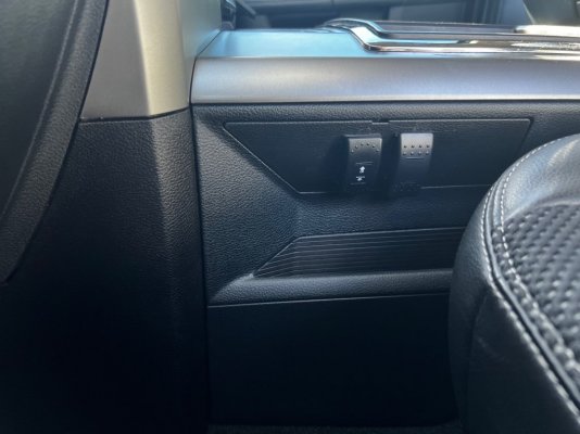

I finally got my switches installed and went back and forth on several locations - on either side of gray trim on center console, or up on the dash next to the instrument cluster, or even using the OEM AUX switches(holy crap $$), but I am tired of spending money and chose cheap Amazon switches and made easily un-doable. No where near as pretty as Randy/Evguy1's shifter, but if/when something better comes along (as far as shift and mode management), I can just replace that cheap insert in the center console, and upgrade.
I've got up and down on a momentary rocker and then the un-labeled switch is a latching DPDT with Sport in the up position, Normal in the middle, and Track in the down position. Works great for shifting on the fly when I am locked out of OD, or selecting the correct gear as I don't have my tune tables nailed down just yet. The car firmware really is great, you can take advantage of so many different tables and such. I highly recommend it.
