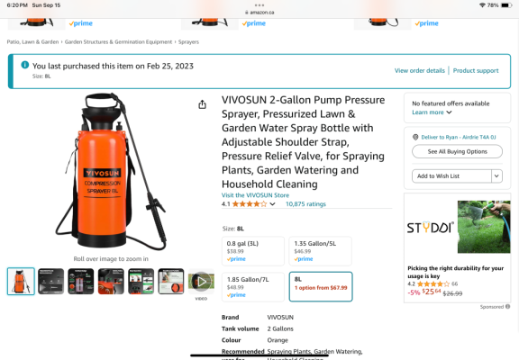

I found you will need to move quick when topping off the fluid and doing the R-N-1-2 shift as the trans warms up quickly. You’ll be over temp if you dawdle.
These make transmission and diff service so much easier. Find one on sale.IMG_4051.png
