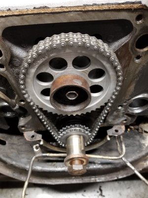

Well, to give a little more information for others that may be considering going down this same path, I towed the truck home. I pulled the front accessories off of the truck and inspected the timing chain. With the standard being 1/2" of slack in the chain, we were FAR out of spec with over 1 1/2" of slack in the timing chain. So, my son and I pulled the old clapped out timing set and installed a new double roller timing set. We resealed everything and are nearly finished up with that portion of the job.

you can do the timing chain on my truck also lol. i wouldn't be surprised if there was that much slack or more. i also got a coolant leak between my timing cover and block and need a new water pump lol. i have been putting it off.

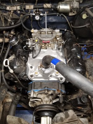

I began our swap from poor '80's fuel injection technology, to carburetion.
I started with a Weiand Stealth aluminum dual plane intake manifold. It's not listed as being for an '88, but the only difference is that this manifold uses the 1978 & earlier larger thermostat and larger thermostat housing.
Intake:
https://www.summitracing.com/parts/wnd-8022wnd/make/dodge
Water neck:
https://www.summitracing.com/parts/fss-84830/make/dodge/year/1978/model/w150
Gasket set:
https://www.summitracing.com/parts/fel-1213/make/dodge

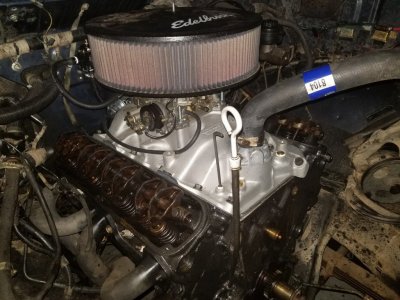

I ordered a Quick Fuel Technologies 650 cfm mechanical secondary double pumper carb, but had a 1406 Edelbrock 1406 carb on my '59 that I thought would be a better fit for this application, so I am going to run the Edelbrock.

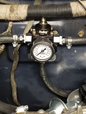

To handle the fuel delivery, I opted to keep the high pressure electric in-tank fuel pump. So as to not burn up the pump from dead heading pressure into the regulator, I opted to run this Holley fuel pressure regulator that has a return line, back to the tank. I re-routed the hard fuel lines up the firewall and mounted the pressure regulator on the firewall.
https://www.summitracing.com/parts/hly-12-887/
This fuel pressure regulator also has a port for a fuel pressure gauge, so we can make sure that the Edelbrock carb is getting the appropriate fuel pressure. I like to run Edelbrocks at around 5-6 psi.

It's coming right along. I think that we should be buttoned up today. The only thing that should hold us up is provisions for the throttle cable and lockdown linkage to the transmission. Should be running in the next few hours.

I also need to pull lines off of the fuel pressure regulator to see if the pump is running and if I managed to confuse the fuel supply and return lines. I'm not getting fuel pressure and need to figure that out. I've either hooked them up incorrectly, or the computer isn't allowing the fuel pump to run, do to something not being plugged in. I poured some fuel in the carb and fired it up for a moment and it ran well.

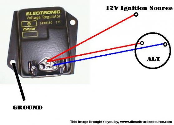

Crazzywolfie, I've been trying to figure out how to get my son's alternator to charge. I ended up doing a search with the keyword "alternator" and your username, since you've helped me so much already! Ironically, I found one that I missed part of right in my own thread! So, I see that you mentioned having to run an external voltage regulator. I will pick one up or order one when I get off work. Do I just grab one for an '87-earlier carbureted truck?
Can you offer any advice on connections/wiring modifications needed? I assume that the ground will stay as is, as will the output wire. What about the other two wires? One (dark blue) currently runs to the ECM and oil pressure switch. The other wire (dark green) currently runs to the voltage regulator. Then, from the voltage regulator shows a dark blue wire going to a ballast resistor.
