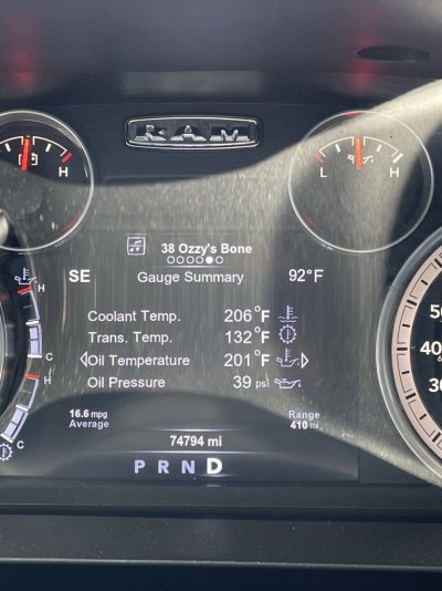

Finally got the time to put in Caulk's valve in the transmission this weekend. Here's my thoughts on the process. There's no need to take the whole Shifter cable off, just unbolt the bracket and move out of the way. Do this with a cold engine! I moved my truck into the shade before and burned my hand on the Cat a dozen times. Get a small bowl or otherwise to catch the fluid, not worried about losing a few ounces but the mess wasn't fun. Have brake cleaner on hand for that lol.
Total install time took about an hour, most of that was trying to find my loc-tite to reinstall the driveshaft bolts. I am very happy with the results. So far the peak I have seen is 140 which is WAY better than the 190 that it was at before just driving around town.
Here are my results, maybe a 30 minute drive around town, mixed city/highway driving
Before
After
Before
After
It is well worth the time to install the bypass. I use to get as high as 188 deg, now when in stop and go traffic it may go up to 162 deg much more acceptable.

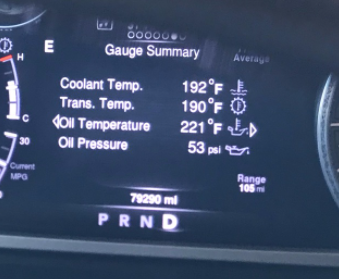

Pic of my ESIC while towing a 4000 Lb travel trailer last week.
180 degree T'stat and shutter delete.
PPE tranny pan
No Caulk Bypass - it's in the cabinet in the garage.
Even with the 180 degree T'stat and PPE pan the tranny temps get way too high for my liking. Engine is much happier though. Never saw Coolant above 192!

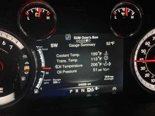

Todays temps short run to grocery store. warmer out today
Nice! Now remove those radiator shutter slats (leave top and bottom one in) and install a 180 Degree Stat and you'll have it knocked. I live in SC as well and coolant runs 185-190 summer and 185 otherwise.
