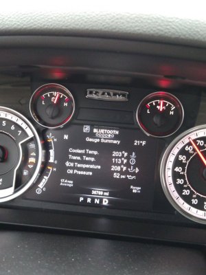

More data for yinz.
This is at the end of my normal drive to work, plus a couple miles then back home a couple hours later. 24miles each way, 60mph cruising, back road ish. Normally the trans is 165 by this point, levels out at 176 if I drive a little further.
The PCM seems to keep the grille shutters closed to warm up the trans, then opens it if the coolant crosses 203-205. The trans levels out here at 110-115 and the coolant settles down as well, seems the PCM is ok with the trans at this temp and stops trying to force it hotter with the shutters.
I'm quite happy with it as is. There is nothing wrong, in my mind, with the trans running at this temp and I can only assume it'll be a little warmer once temps return to a hospitable level.
I don't suppose you've layed into the throttle hard a couple times in row have you.It's -40 here so mines parked,but i'd like to see what happens to the temp with a couple back to back hard acceleration pulls from a stop or a slow roll up to 65 mph or higher.

As you's request.
Tried to take a video, but hit the wrong button of course. Instead got two pics, before and after a slight uphill pull from 65 to whatever it shuts off at (105?). The shutters were obviously still closed or mostly closed since the coolant temp rose like it did, but the trans climbed immediately then slowly dropped a few degrees the last two miles to home.
I wonder where the temp sensor is in the fluid path...

As you's request.
View attachment 236753 View attachment 236754
I wasn't expecting you to wind it out to wide open,lol.But thank-you for that test.Hows the shifts feel under full throttle

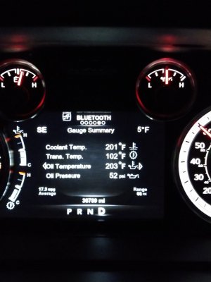

Cold this morning, still made it to a reasonable temp on the ride in. Clearly still in what Dodge thinks is an acceptable range.
