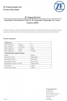

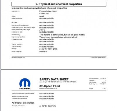

Also found an Australian sds for 8+9 speed atf mopar 68218925AA and it had very little info on the properties.
Lots of no data available, etc.
In fact, it only had the viscosity at 40°C listed.
Also, it listed the color as red, which is BS

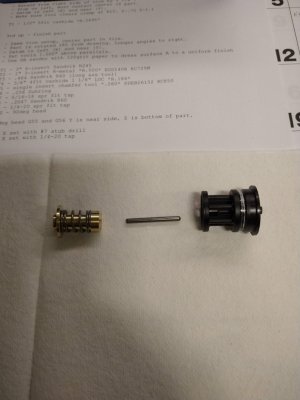

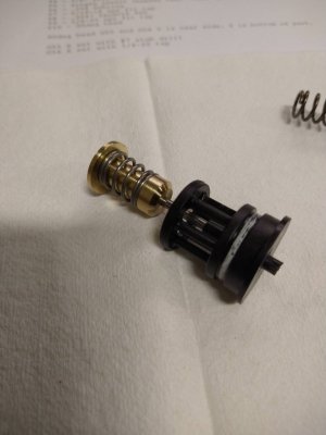

Putting this here as at least a temporary informational post for installation.
First is the parts you'll pull out of the thermostat housing.
Second and third are the parts you'll put back in.
IMG_20210208_133124677.jpg IMG_20210208_133141562.jpg IMG_20210208_133200904.jpg
- Remove the factory thermostat and spring from the thermal unit.
- Slide the factory thermostat off of the small pin and replace it with the new valve. Be sure the pin is seated in both the valve and the cap.
- Insert the new assembly into the thermal unit. It should go nearly all the way in, then require light pressure with one finger to compress the spring then a bit more to seat the o-ring of the plastic cap. Reinstall the snap ring. Be sure the snap ring is seated into the groove!
